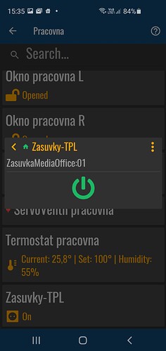

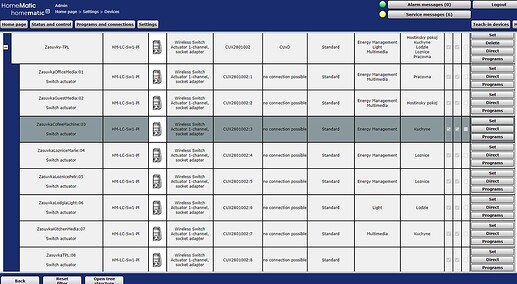

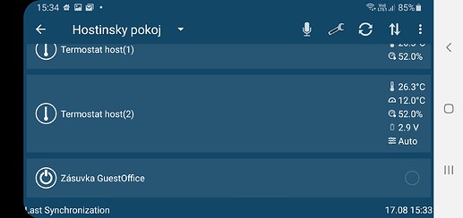

Yes, this is primarily provided by the TCL script (see the link to the HM forum), TP link sockets are then normally seen in Devices with the help of CUxD, as well as the original HM sockets (see printscreen)! .
Sockets are assigned to Rooms and Categories, in the TinyMatic App they can be seen perfectly as they should.
In Smartha only one of them is displayed (see printscreen), only the first one from the list in Devices,

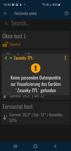

for others Smartha shows an error (see printscreen).
HI @omicronCZ,
thank you for the clarification, I see the problem, this is clearly a bug. We will check and fix it in the next versions.

I am sorry, I was wrong. The problem ist that you are using a CUxD device type (HM-LC-Sw1-Pl) which only have 1 channel in reality. Our definitions are based on real devices - thats why you just see the first one. In your room ‚Pracovna‘ you should see the first channel.
You will need to modify the device definition or create a custom one for this device manually and add the missing channels. The other option is to use a ‚real‘-device type which supports that cound of channels. Currently there is no other way to do that.

oh, so that’s bad, I have definitions as described in the TP socket add-on (see link above). Interestingly, there is no problem in the TinyMatic application. Or is it possible to solve it?
