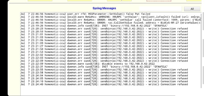

Wenn ich die Option "XML-RPC überspringen? deaktiviere bekomme ich bei jedem Abruf Error und Warnings auf der CCU.
Nutze die neueste Raspberrymatic, Ports: alle offen, nur lokale Verbindung hinterlegt.
Auszug aus dem Log der ccu:
Jun 10 13:20:01 homematic-ccu2 daemon.info cuxd[623]: INIT ‚binary://192.168.0.42:2022‘ ‚EFAAFELC‘ Jun 10 13:20:17 homematic-ccu2 daemon.info cuxd[623]: INIT ‚binary://192.168.0.42:2022‘ ‚EFAAFELC‘ Jun 10 13:20:53 homematic-ccu2 daemon.err cuxd[623]: sendbinrpc(192.168.0.42:2022) - write() Connection refused Jun 10 13:20:54 homematic-ccu2 daemon.err cuxd[623]: sendbinrpc(192.168.0.42:2022) - write() Connection refused Jun 10 13:21:17 homematic-ccu2 daemon.err cuxd[623]: sendbinrpc(192.168.0.42:2022) - write() Connection refused Jun 10 13:21:31 homematic-ccu2 daemon.err cuxd[623]: sendbinrpc(192.168.0.42:2022) - write() Connection refused Jun 10 13:21:35 homematic-ccu2 daemon.err cuxd[623]: sendbinrpc(192.168.0.42:2022) - write() Connection refused Jun 10 13:21:37 homematic-ccu2 daemon.err cuxd[623]: sendbinrpc(192.168.0.42:2022) - write() Connection refused Jun 10 13:21:38 homematic-ccu2 daemon.err cuxd[623]: sendbinrpc(192.168.0.42:2022) - write() Connection refused Jun 10 13:21:42 homematic-ccu2 daemon.err cuxd[623]: sendbinrpc(192.168.0.42:2022) - write() Connection refused Jun 10 13:21:53 homematic-ccu2 daemon.err cuxd[623]: sendbinrpc(192.168.0.42:2022) - write() Connection refused Jun 10 13:22:17 homematic-ccu2 daemon.err cuxd[623]: sendbinrpc(192.168.0.42:2022) - write() Connection refused Jun 10 13:22:18 homematic-ccu2 daemon.err cuxd[623]: sendbinrpc(192.168.0.42:2022) - write() Connection refused Jun 10 13:22:18 homematic-ccu2 daemon.warn cuxd[623]: disable events to 192.168.0.42:2022 Jun 10 13:48:02 homematic-ccu2 daemon.info cuxd[623]: INIT ‚binary://192.168.0.42:2022‘ ‚EFAAFELC‘ Jun 10 13:48:14 homematic-ccu2 daemon.err cuxd[623]: sendbinrpc(192.168.0.42:2022) - write() Connection refused Jun 10 13:48:30 homematic-ccu2 daemon.err cuxd[623]: sendbinrpc(192.168.0.42:2022) - write() Connection refused

Hier noch eine Logmeldung, welche nur Auftritt, wenn der XML RPC Init aktiv ist.
Jun 13 07:28:41 homematic-ccu2 user.err rfd: XmlRpcClient error calling event({[methodName:„event“,params:{„EFAAFELC“,„OEQ1711968:4“,„CONTROL_MODE“,0}]}) on http://192.168.0.42:2021/: Jun 13 07:28:41 homematic-ccu2 user.err rfd: XmlRpc transport error Jun 13 07:28:41 homematic-ccu2 user.err rfd: XmlRpcClient error calling event({[methodName:„event“,params:{„EFAAFELC“,„OEQ1711968:4“,„FAULT_REPORTING“,0}],[methodName:„event“,params:{„EFAAFELC“,„OEQ1711968:4“,„BATTERY_STATE“,3.100000}],[methodName:„event“,params:{„EFAAFELC“,„OEQ1711968:4“,„VALVE_STATE“,0}],[methodName:„event“,params:{„EFAAFELC“,„OEQ1711968:4“,„BOOST_STATE“,0}],[methodName:„event“,params:{„EFAAFELC“,„OEQ1711968:4“,„ACTUAL_TEMPERATURE“,24.000000}],[methodName:„event“,params:{„EFAAFELC“,„OEQ 711968:4“,„SET_TEMPERATURE“,5.000000}],[methodName:„event“,params:{„EFAAFELC“,„OEQ1711968:4“,„PARTY_TEMPERATURE“,5.000000}],[methodName:„event“,params:{„EFAAFELC“,„OEQ1711968:4“,„PARTY_START_TIME“,0}],[methodName:„event“,params:{„EFAAFELC“,„OEQ1711968:4“,„PARTY_START_DAY“,1}],[methodName:„event“,params:{„EFAAFELC“,„OEQ1711968:4“,„PARTY_START_MONTH“,1}],[methodName:„event“,params:{„EFAAFELC“,„OEQ1711968:4“,„PARTY_START_YEAR“,0}],[methodName:„event“,params:{„EFAAFELC“,„OEQ1711968:4“,„PARTY_STOP_TIME“,0}],[m thodName:„event“,para Jun 13 07:28:41 homematic-ccu2 user.err rfd: XmlRpc transport error

Hi, beim Thermostat ist das so.
Das Problem mit Init besteht aber weiterhin.
App ist die ganze Zeit geöffnet und aktualisiert auch die Daten.
Es ist dann immer so, dass alle 10 Sekunden Errormessage kommt:
Dann disbled die CCU es:
Und 20 Sekunden später wird erneut versucht die Connection aufzubauen:ccu2 daemon.info cuxd[623]: INIT ‚binary://192.168.0.42:2022‘ ‚EFAAFELC‘
Dann wiederholt sich das Ganze bis man das in den Syseinstellungen deaktiviert.
Gibt es noch einen Ansatz woran das liegen kann?
